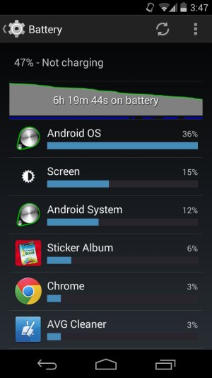

Hey, thanks for the reply! My screen time is not even one hour, I charge my phone before sleeping to 100% when I wake up, its like 60%. Phone not even in use, signal strength is strong, wifi and locational services all off. The android os battery usage is always high since the new update regardless of however long i use my phone. I'm only getting around 6 hours of battery while only using my phone for maximum one hour in total.
I cleared the system cashe partition but that also didn't seem to make much of a difference.

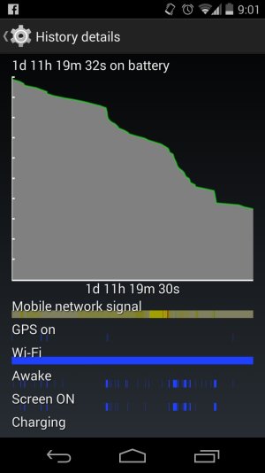

From 100% charge to 47% took 6h but screentime only 1hr 2 mins (usually i would get through almost 2 days from 100% to around 10%)
Then on another day, 100% to 8% took 15h with screentime only 1h 16mins. Screenshots will follow.
The more recent screenshots seem to show more awake time than the older one (that showed better battery life), so you might be using the phone more, or your apps might be keeping the phone awake for some reason. Unfortunately, when OS is the main battery consumer, it can be hard to pinpoint what exactly in the OS is using battery.
