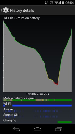

Not a problem. Easy enough for me to get that for you. Here is a brief screen grab from when I disconnected the standard LG charger that came with the phone and plugged in the Belkin 2.1A charger. I understand charging appears to slow down as it goes through the cycle but I didn't expect the sharp incline in the charge.

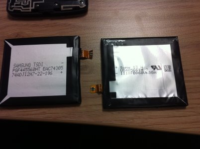

Here is a picture of the two batteries side by side. Did LG/Nexus change the manufacturer at a later date?photo.jpg
I can't find any info on the Sony one but find a few things on the Samsung part number.
