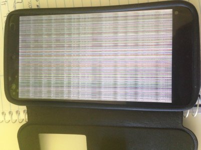

Hello all! Some time ago my nexus 5 started to have some issues with the microphone and a couple of days after it stopped working. I searched how people generally fix it because I have no warranty and I didn't want to spend much money giving someone to fix it or even get another phone. So what I did was I open the motherboard plastic protection and put a tape (a bit thick) right below the camera (above the battery) to make some pressure on the mic connection. I closed it, closed the phone, turned it on and the mic was working again. So far so good.
Then I noticed that out of nowhere the screen went black and if I pressed the power button it would give only black light. After some research again I noticed that it wasn't the LCD problem because if I rebooted the phone (power button + volume down) it would work perfectly, but after some time it'd go black again. Sometimes it even makes weird colors, grey orange and some lines (like broken screen) and then goes full black.
I already factory reseted the phone but the poblem still persists. I wonder if it has something to do with the battery (maybe should get a new one) or with some hardware connections. What makes me think that isn't a hardware problem is because it always works during some time when I reboot it. But ofc im not 100% sure because it looks like this happened a little while after the mic fix.
I saw someone talking about memory cache wipe could fix this. I didn't try this yet because I dont have the phone right now, but I'll test that in like 1 hour. But then I ask, shouldn't factory reset clear cache memory?
I hope I explained everything well if you have any doubt please do ask. I'm just trying to know exactly what the problem is so I don't waste time and money fixing actually not problematic parts.
Thank you.
PS: I'll atach a pic of how crazy the screen goes sometimes befor it goes black
Hi! Oh my, that is an unfortunate circumstance! I am sorry that you are going through this.
Having had a Nexus 5, myself, I'm just curious as to how long you've had this specific device. It could be the battery, or maybe opening up the motherboard snagged something.
I would contact customer support or go to your carrier and see what they suggest. If they can give you a quote on how much it would cost to fix your device, or a rough estimate, then you can decide if you should fix it or perhaps get another phone. Please keep us posted!

Yes I forgot to mention, this device was used by a family member for like almost a year.
Update:
I did clear the memory cache but I believe that's not the problem.
Another thing happened, I was just trying to reboot it to make the screen work again and it wasn't working. It started to give those colors that I showed in the picture above. So I connected it to the charger, waited a bit, tried to reboot again and it worked. The screen is now temporarely on and working what makes me think even more that it could be battery's fault.
I'll tr to talk with my carrier aswell.
Thank you
