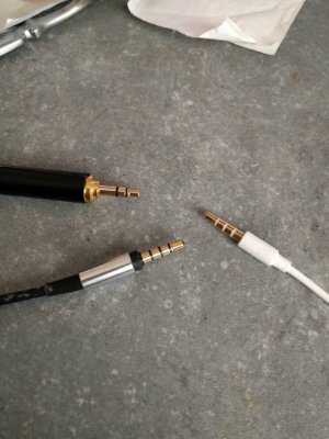

Not so... I believe the 6P has an extra connection on the 3.5mm Jack for headphone control, same as my S6 had. You'll need to buy an appropriate lead to make it work. Here are.. that's a standard 3.5mm lead on the left and my B&W P7's are the silver and black lead... The S6 phones lead is all white.

.... And both IOS and Android use different wiring for their devices ie Apple headphones would not work correctly on an Android device and vice versa.
Be that as it may, the audio output is a standard. OP isn't complaining about not being able to skip tracks, he said there's no output at all.
The signal and wiring that drives Audio is industry standard
