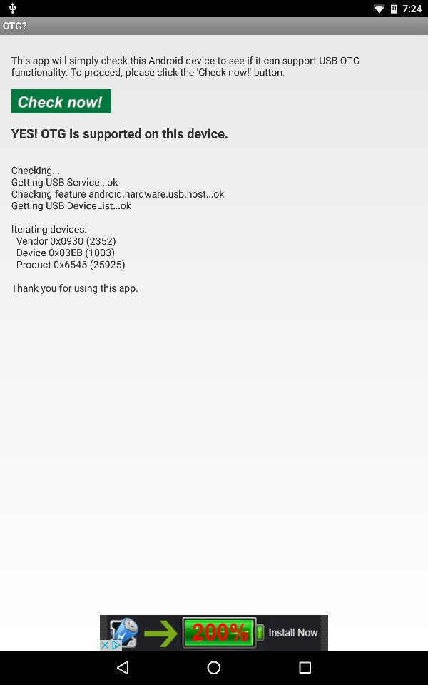

1. Do I have OTG? (YES, OTG is supported on this device.)
Did you have your OTG cable and a USB storage device connected when you ran that app? If so, the output should have looked something like this

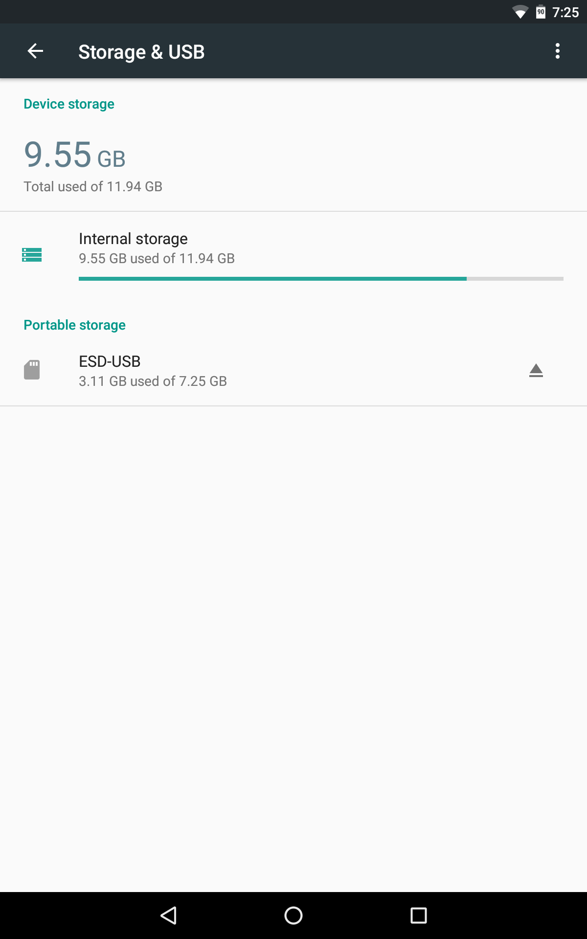

which shows that a device was connected. And if you looked in Settings -> Storage & USB you should have seen something like this
(note the lower portion of the screen which shows the USB storage device).

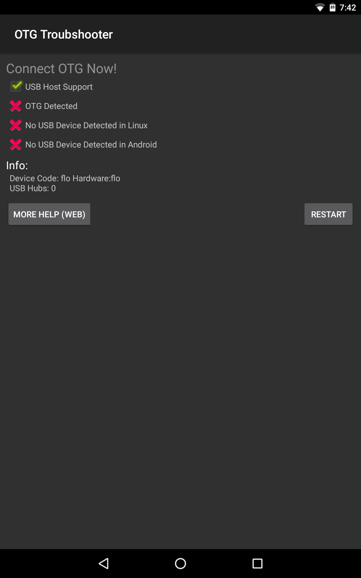

2. OTG Troubleshooter? (Mixed response)
a. first try it passed all but "No USB Devise detected in Android"
b. second try it passed "USB HOST Support" and failed everything else​

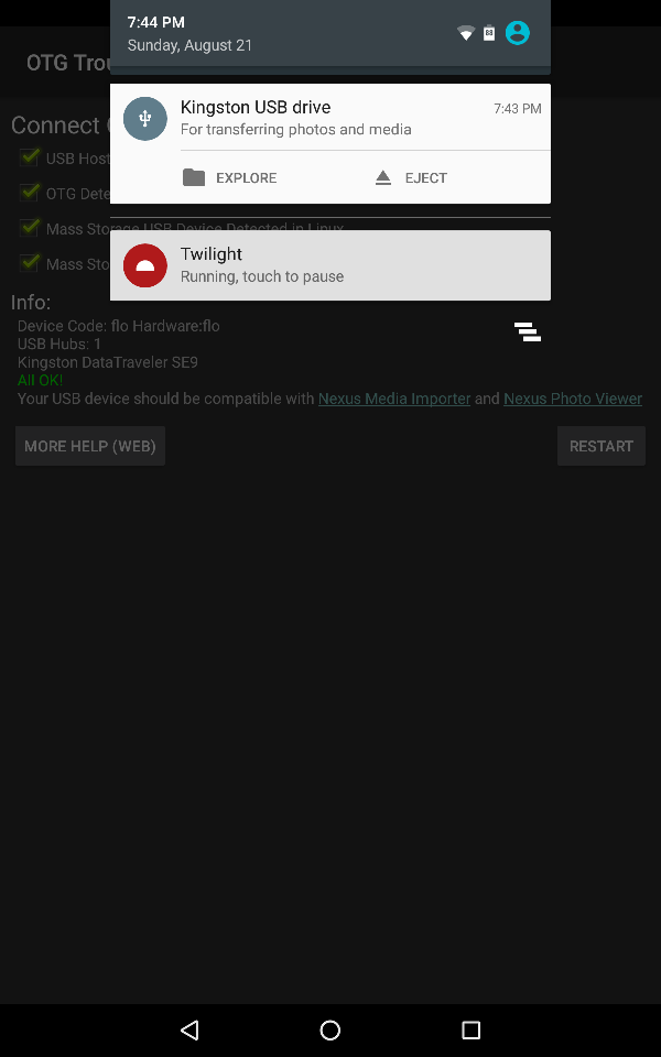

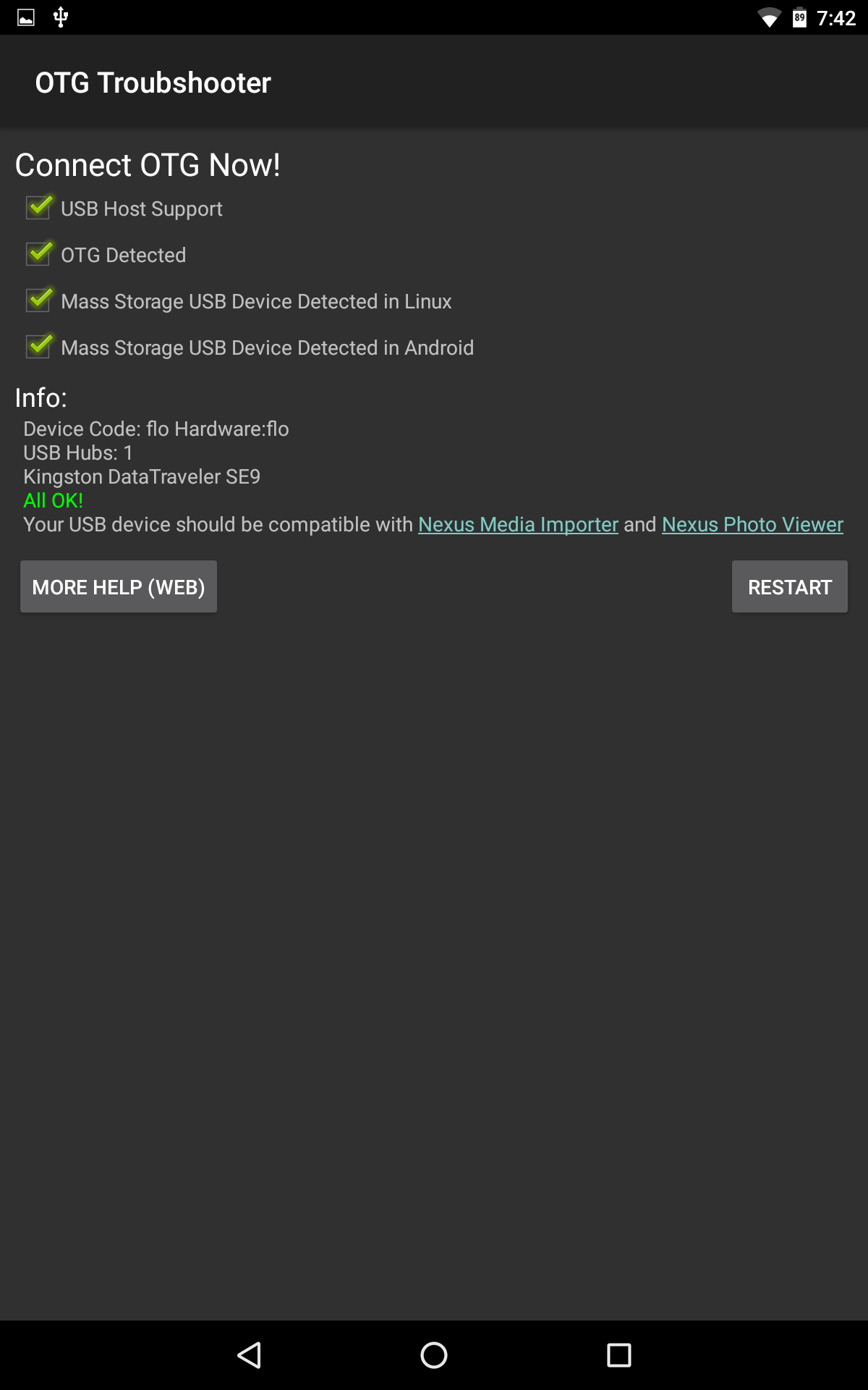

Same question as previous - this app expects (and prompts for) the OTG cable and device to be disconnected at the start, and it should look like this
then you connect the OTG cable and device and it should detect them and show
and if you observe the Notification Shade you'll see a little USB icon and when you drag down you'll see something like this
If you don't see something very similar to these results there's probably something wrong with your OTG cable and/or USB storage device.

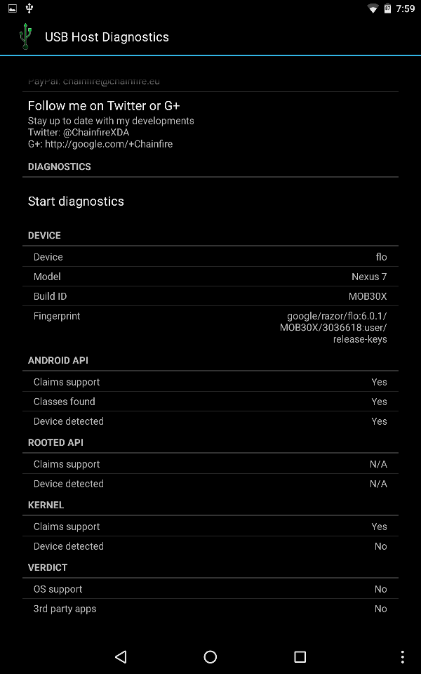

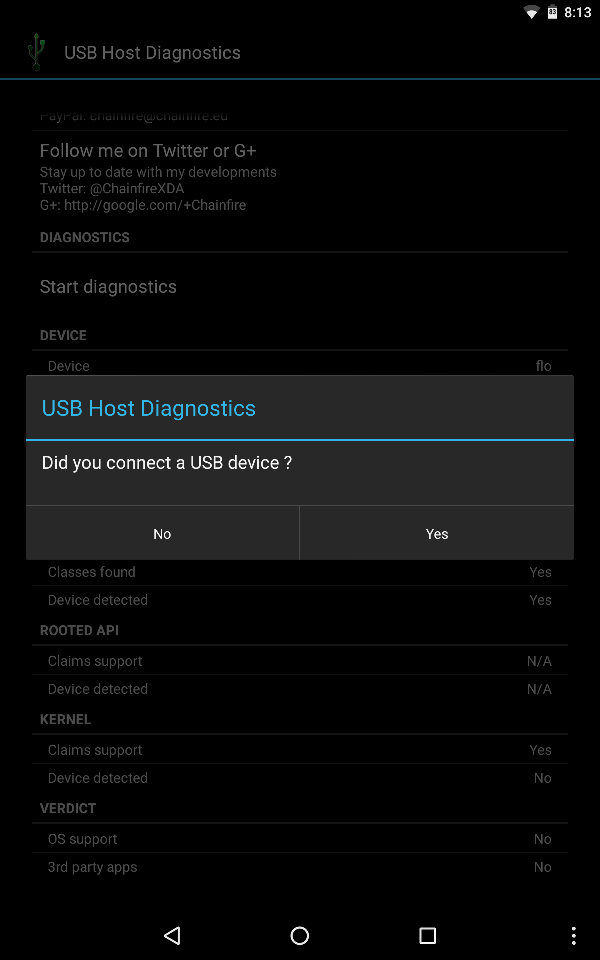

3. USB Host Diagnostic? failed
Same as before - when you select 'Start diagnostics' you should see
and after connecting the OTG cable and device, counting to ten and selecting the Back button you should see this
(note the three 'Yes' results under the 'Android API' heading). If it didn't detect a device but your OTG cable was good you should have seen
Do I have OTG? Yes I get the same result.
OTG Troubleshooter?
a. First screen YES.
b. Second screen NO. (Connecting device has no effect.)​
USB Host Diagnoses?
Android API:
a. Claims Support: Yes
b. Classes Found: Yes
c. Device detected: No​
Kernel Support:
a. Claims Support: No
b. Device Detected: N/A​

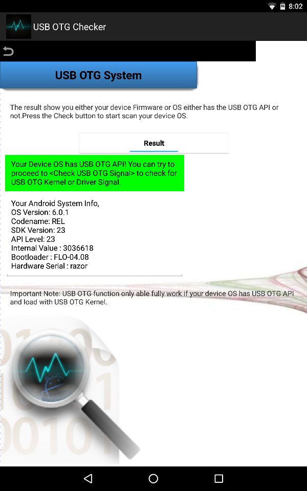

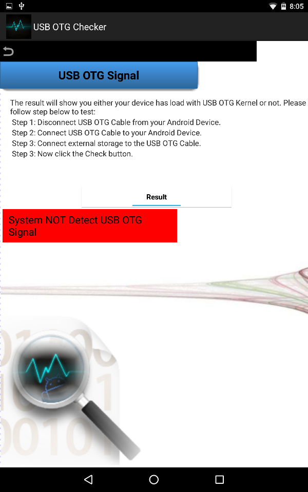

4. USB OTG Checker "System NOT Detect USB OTG Signal"
Unfortunately this last app seems iffy - the 'Check Device OS on USB OTG' functionality seems to work ok
but 'Check USB OTG Signal' fails on my device as well
- sorry.
