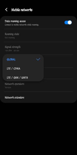

In the systems settings, search for Preferred Network Type. What's that set to?
I can't find "Preferred Network Type," but I found Settings - Connections - Mobile Networks - Network Mode. This shows "LTE/3G/2G (auto connect)" as the selected option. I can choose from Global, LTE/CDMA, GSM/UMTS, or CDMA from the drop down menu. I've tried all of these with no luck.

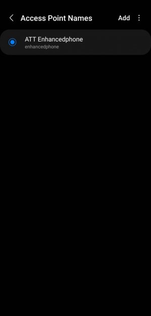

Go to settings >connection >mobile networks >Acces Point Names then tap , show a screenshot there?
Under Network Mode, can you choose LTE Only?
Mustang7757, here's the screenshot showing the APN. I've tried using TFDATA and VZWINTERNET as well. Same result, no mobile network connection.
B. Diddy, unfortunately, there's no option for LTE only.

Thanks it should be highlighted like mine, tap the 3 dots to the right and choose reset default see if it gets highlighted Screenshot_20220219-201429_Settings.jpg
It has to be a Tracfone problem. I have an S10+ on postpaid Verizon. Here's what mine looks like. Screenshot_20220219-202307_Settings.jpgScreenshot_20220219-202321_Call settings.jpg
I can tap the circle and it will light up blue, but "Reset to default" under the three dots is grayed out. Even when the circle is blue, no LTE.
