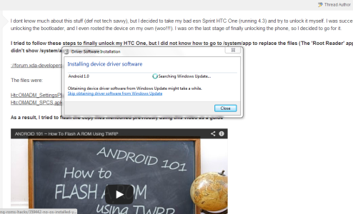

'No OS Installed! Are you sure you wish to reboot?' PLEASE help!
I chose 'Mount', then selected partitions 'cache', 'data', and 'system, then selected 'storage:internal storage' and then 'ok', but it didnt work. Then I noticed this pop up on my pc :/ Capture.PNG
