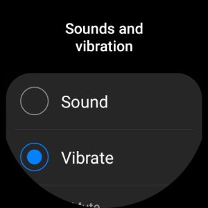

Out of curiosity, do you have the watch system settings set for vibrate all? It's the first set of options under settings>sounds and vibration.
Maybe this can force to vibrate when on calls?Screenshot_20230325_094438_settings.jpg
Sent from my SM-F926U using AC Forums mobile app
Mine is set to sound, but below it I have sound and vibrate checked.
I think it's the Bluetooth aspect, watch is connected to phone and Bluetooth headset is connected to phone, they don't want to share the sound.
I just tested this out and watch stays silent and no vibrate. Only thing that works while using headset is forcing LTE on the watch. Thanks for suggestion though, worth a shot.
