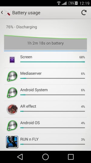

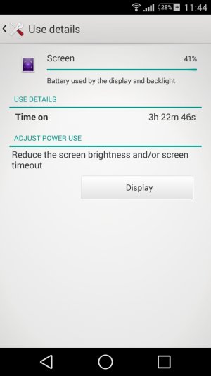

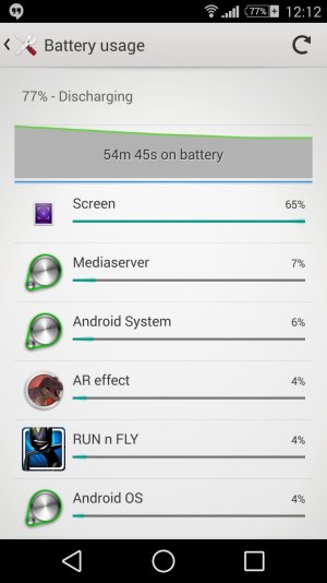

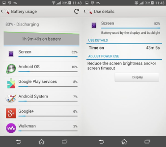

Okay.. so i got the phone at Tmobile as a vday gift for myself because why not? but as soon as I was handed the phone at the counter, I noticed that it had 98% battery life. That was only after it was set up with my Google account and testing to make sure my number worked. I also noticed how warm the phone was. It hadn't even been 5 mins since the device was turned on. Whatever maybe I was judging too soon. Took it home played on it none stop and it felt like that battery was dropping as fast as my LG's L9 does.. And because of the L9 I feel like I'm a master at conserving battery life. It was on airplane mode 90% of the time. So on the Z3, I turned on STAMINA mode right away.
Same Phone different day, i get different result for different days, it's "fun".

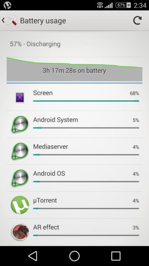

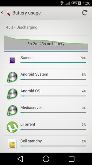

It's showing that your screen is on approx. 75% percent of the time, this would eat battery power up for sure. What is your screen timeout set at?
Rob
3 and a half hours on my phone and my screen is on 75% of the time? I don't really get that. But screen timeout is 30 sec but I always manually turn off my screen by habit.

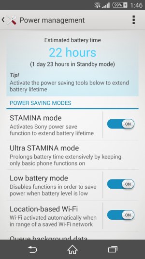

Well how about this, can someone please screenshot the Power Management - Estimated batter time when they first unplug it from the charger at a 100%? How many hours is normal for it to say?
There is something way wrong w/ your phone: I get almost two days out of my Z3 w/ "active" use. I unplug my phone (6 A.M), use it all day and get home around 8:00 P.M. and it's still over 50 (if not 60)% ! I'd return it ASAP! -Davis
I went into Tmobile yesterday and they ran "diagnostics" and said everything was fine.
But here's a screenshot when I first unplugged. Gives me 22hr bat life estimation
That 22 hours of battery life is usage time; phone calls, music, Internet, etc. Does not really take into account screen on time, usually between 5-7 hrs.

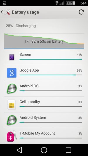

You should check the app power consumption in that menu to see if it is an app. After that I would turn off low power and stamina mode after a full charge and just use it as normal for a few days.
I've done all that already. No app is consuming my power, just the screen and I know that is completely normal. It was acting this was way when I first got the phone with standard app installed and already up to date. I updated installed apps, nothing changed.
I've done the option of taking it off stamina mode, and it lasted less than 10 hours with only 1 hr screen time and I only used to phone to check the time during work.

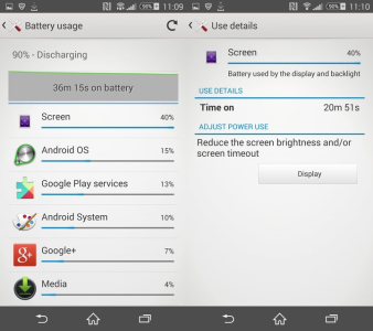

So just as a point of reference, I unplugged my phone about an hour ago its at 98%. Power management says that I should get 1day 10hours of use (not on stamina mode). My thought is that the only way you will know for sure if its the phone is to do a factory wipe and check again. But by everything you have said so far I concur that it would be the phone itself. In fact, looking over you screen grabs it shows that your screen is approx. 70% of your total discharge. Mine is usually more in the 40% range, less if I reduce the brightness.
