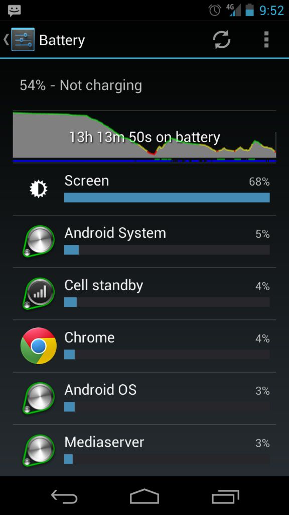

My phone won't charge at all while its turned on I've tried different cables different bricks and have plugged it into my computer but still no go. But, when I turn it off it apparently is charging..
Okay so I did a battery pull and when I booted up it was at 54% when I did the pull it was at 10% also notice how it says "not charging" instead of discharging and notice the sudden drop and then rise
