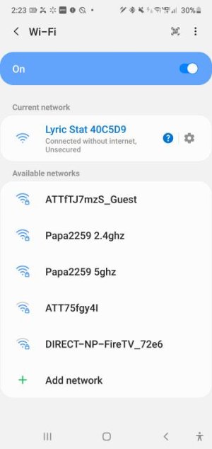

I'm not very knowledgeable with communications, but would the speed of my wifi be a problem? My 2.4 ghz shows a speed of 144 mps. My 5 ghz shows a speed of 866 mps.

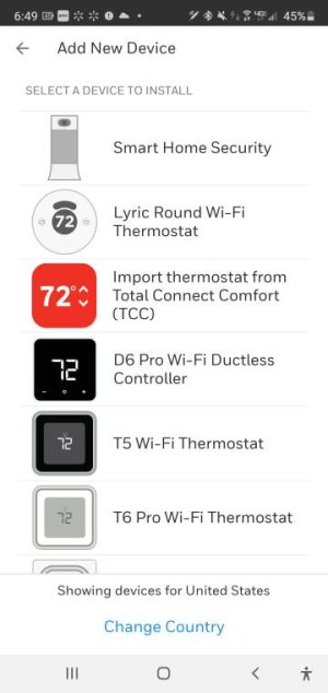

I realize that. When i try this procedure I'm on the 2.4 ghz. But when the honeywell app tries to connect it tries connecting to the Lyric line.

One of the try this is to move close to the router if you have a slow signal. I'm getting a speed of 65 mps. My router is 5 ft away from the thermostat. I think i have an at&t problem. Would you agree with me the speed (s) are to low?
That is correct. I'm on the 2.4 ghz 'line' then when i attempt to bring the thermostat online, they want me to take the Lyric 'line' and have it connect to my wifi

Honeywell has a few different apps in the Play store, so make sure you have the right one installed.
