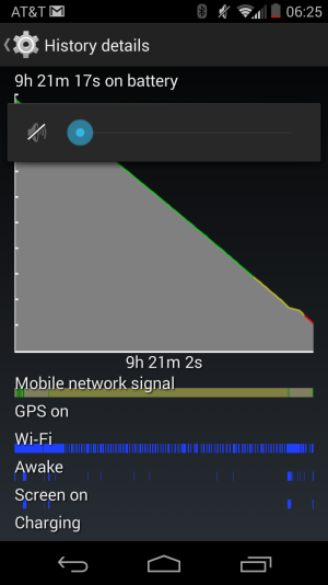

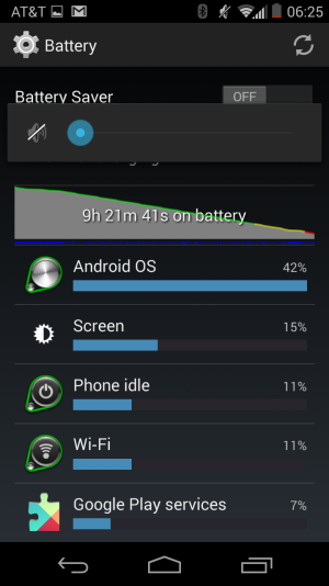

I'm leaning towards that direction. I started up a few apps last night to see the battery drain overnight (when the phone is doing absolutely nothing) I even installed Battery Defender to try and get more info. The overnight results were horrible. My battery life dropped from about 92% to 18% in close to 9 hours with the phone doing absolutely nothing. I've attached screenshots showing the battery life. There's no way this can be "normal" or caused by an app or a setting.
That is a substantial battery drain overnight. time to exchange it my friend. Overnight I see MAYBE a 10% battery drain when the phone is doing nothing. Thats with no sleep mode activated, all apps pushing and wifi on.
