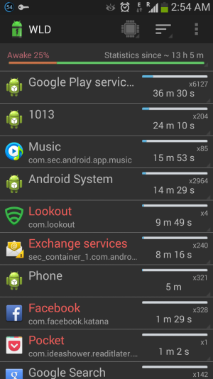

This are what the wakelocks look like now. :)
I think my problem has been solved, regained the awesome battery life of 4.1.2
Others can try this too and share their observations.
All I did was follow this sequence Factory reset->firmware upgrade->factory reset before use.
