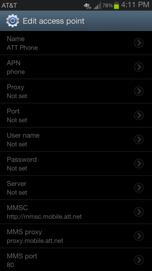

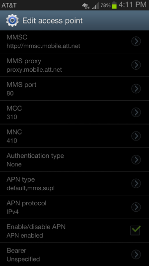

When you get a chance go to settings> more> Mobile networks> access point names> hit the selected access point
Post up what the settings are please.

Here u go

Sounds good... went by AT&T earlier and the slapped in a shiny new sim card.. wanted me to try that.

Ok so she has the Galaxy Note (original) here settings are almost the same except
MMS=not set
MMS proxy = not set
MMS port= not set
APN type=internet
