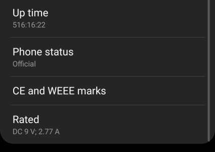

Never had any restart issues...
Been 21 days since i last rebooted.
