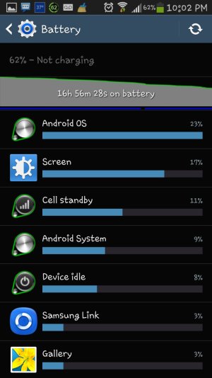

Ok so for some reason my battery just started going dead faster than normal. This is a slow days use but look at the attached pic

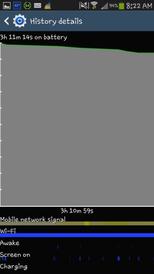

Tap Cell Standby--is there a lot of Time Without Signal? This can cause more battery drain.
No hardly any time without signal. I will post a pic this afternoon of the down time. But it varies from day to day on ow long it sets idle. More on some days. On this day it did set idle a little bit.

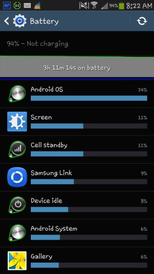

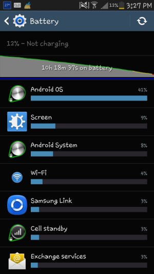

Here are 2 pictures from this morning with about 3 hours of charger. so far this morning it has been off alot. As you can see from prior on the say at 10 hours use i was at 12% but day before that io as at 62% on 16 hours. It is very strange. Not much changes in my daily routine really.

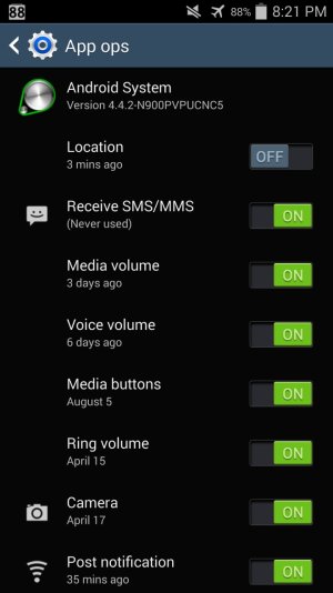

I found an app called AppOpps , and what that allows you to do is turn off individual permissions that every app on your phone has. And it shows you in real time, what app is using what resource.
For example I found out that GoFlashlight was using the camera in the background (uninstalled out of principle). Skype was using the camera in the background even though I was signed out of it. Etc etc.
When it came to apps that were using my location, one of them was a package called .... Android System v 4.4.2 ....

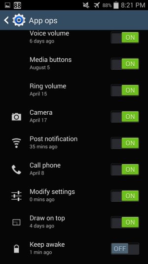

So what I did was to turn off its permission to use Location, and if you go all the way down, you can turn off the Keep Awake permission.
That's it! Enjoy your great battery life once again!
