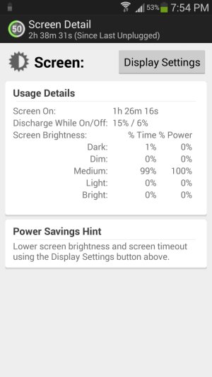

Here's what I see now - look at "Discharge while off"
Before I made the change two days ago, I was seeing the opposite - in other words, I saw like 12% with screen on and 18% with screen OFF. Now I see 15% with screen ON and only 6% with screen OFF. That's a huge difference; enough to kill battery quicker than now.

Here's the snapshot --

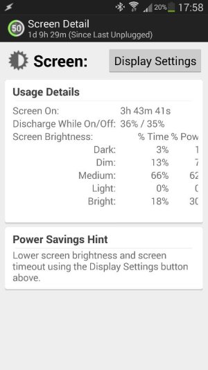

even with the stock wall paper mine says on at 11% and off at 17%

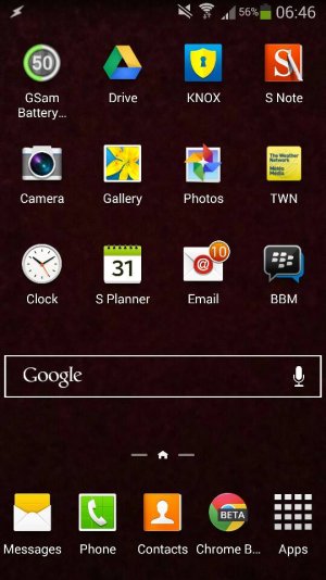

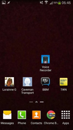

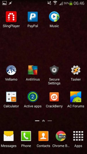

What other widgets are you running?
Now last night I use the back theme (photo shot) I was at 65% 6 hrs later the phone was at 56%.
Here what is on my phone
Sent from my SM-N900W8 using AC Forums mobile app

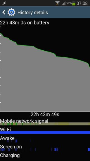

Look at this one. I wonder if the 35/36 (or vice versa) has something to do as a % for the phone from 100% charged to 20% remaining battery state. What if that % is the sum of use for a battery cycle?
When I first look yesterday morning those number were pretty low
