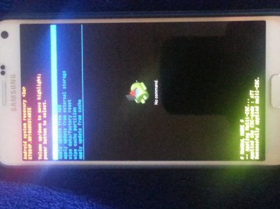

Mine boots right into recovery.
Each time, before the screen where you can select ADP, wipe, etc., appears it says "Installing system update..."
But it boots into recovery no problem. With the phone off I press and hold up, home, then sleep--in that order--until I see booting into recovery mode in the upper left-hand-corner of the screen.
Mike
