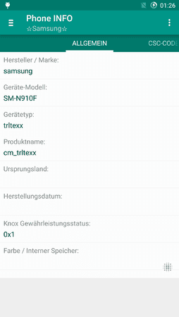

Hello all,
please find below more info about my device; created with "Phone INFO Samsung" app:
