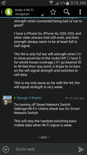

This may help you.
I am still getting full bars of wifi all around my house... I do have a really good router that has awesome range so that helps.. But so far I'm not noticing anything different than my Note 3.

This may help you.

This may help you.

WTH??? Taking credit for my previous post by screen-shotting it, re-posting it and then agreeing with it. Not cool, man.
Dude simmer down. He quoted you above and said "This may help". The purpose of his screenshot was to show he had full wifi reception.
What? I was reading your post and snapped a screenshot to show you my wifi strength... Then I quoted what you said and told the OP this may help... As in your suggestion may help him. I wasn't taking credit or claiming anything ? :?.
