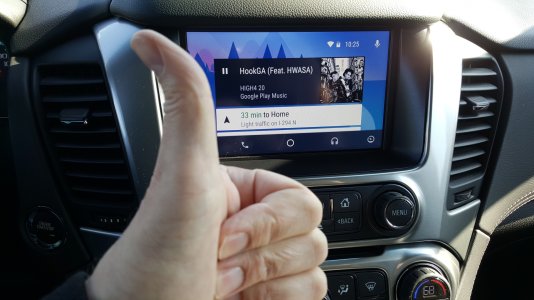

My Note 5 was working perfectly for 3 weeks with my new 2016 Suburban. Then this morning I got the "plug in compatible USB device" message on the vehicle's LCD screen.
I knew something was different as soon as I plugged the phone into the USB port. It asked me to allow MTP connection, which it never did before. Even though I answered yes to allowing MTP connection, the phone remained in charging mode.
In the past Android Auto just took over, turning on bluetooth and opening the app on the phone as soon as I plugged it into the USB port.
Turning on the developer options and enabling USB debugging did the trick. After doing so and plugging into the USB port again, the phone did not ask me about allowing MTP and it fired up Android Auto like it used to.
