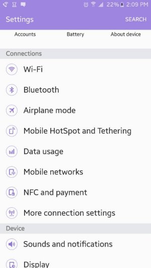

Re: wifi calling
Yup, if I turn on WiFi calling, then I have this icon at the left.

Re: wifi calling
Yup, that means WiFi calling is connected, but it doesn't mean that you're actually getting calls routed through WiFi. When you're IN a call, what color is that icon? If it's using WiFi, it should be green.
