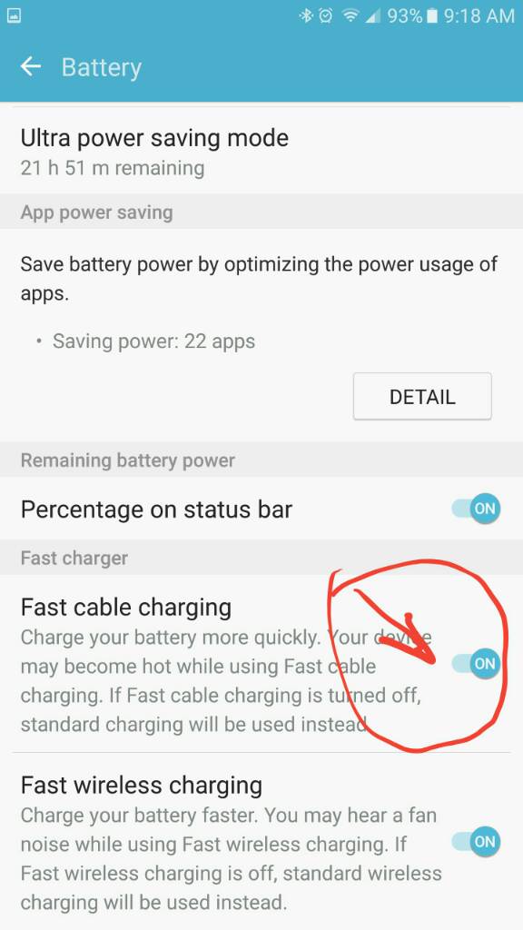

You do have fast cable charging turned on right?
