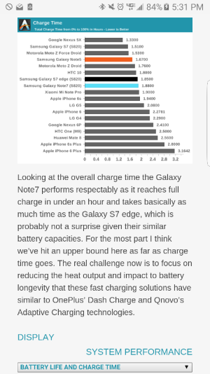

Unless your device charges way faster than the unit anandtech used, there must be something wrong with your wife's device or charger. Screenshot_20160824-172713.jpg Quick charge 2.0 can charge my device in less than 2 hours so I can confirm it's correct for the Note charge time. It's faster than what Google is using with the Nexus, plus it's much easier to identify a quick charge 2.0 compatible charger than the standard USB C charger. Personally, I think quick charge is superior and I'm glad they used it although 3.0 would have been better. Screenshot_20160824-173159.png
Oh yeah, even if you weren't counting the extra 40 min it was drawing power after saying it was at 100%, the technology in the 6p would probably still be considered inferior because of the charge time in relation to the battery sizes.
