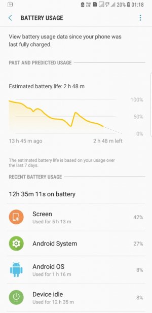

Hi,
I'm using a Note 8 which runs Exynos 8895 . I have moderate use and about 100 apps installed. I'm really hesitant about a factory reset. After full charge, I barely get 12 - 14 hrs even after charging the device 2 times. Check out the log below. The 'P' indicates medium power saving mode.
I run at 1080P most of the time. Always on Display is on but due to the LED cover, the AOD remains off.
Is there a battery issue or is this poor battery performance normal?
I was using a Note 5 previously and it's battery life was excellent. It would easily last me a day.
It loses about 4-8% every 45 minutes with mobile data on!
I even turned off background data usage but about the same SOD...
Please suggest.

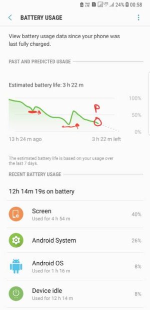

With medium power saving mode, already lost 4% in only 20 minutes. Is this normal?
Here are the settings for Medium power saving mode :
Screen : HD+ 720P
Background data usage restricted
Always on display turned off
CPU Speed limited
Brightness 10%
Is it normal to lose 4% in 20 minutes with this config or no?

Your Android System seems to be sucking a lot of power for some reason. Might want to try and clear your system cache as well as the cache of internal storage. Instructions to do both below:
Note 8 storage cache clear: settings- storage- internal storage- cached data- tap on it to clear
How to wipe the cache partition on the Note 8:
Back up data on the internal memory. I've never lost any data from this process, but just in case, back up important stuff.
Turn off the device.
Press and hold the Volume Up key and the Bixby key, then press and hold the Power key.
When the Android logo on a blue background displays, release all keys ('Installing system update' will show for about 30 - 60 seconds before showing no command for a few seconds followed by the Android system recovery menu options).
Press the Volume down key several times to highlight 'wipe cache partition'.
Press Power button to select.
Press the Volume down key until 'yes' is highlighted and press the Power button.
When the wipe cache partition is complete, “Reboot system now” will be highlighted.
Press the Power key to restart the device.

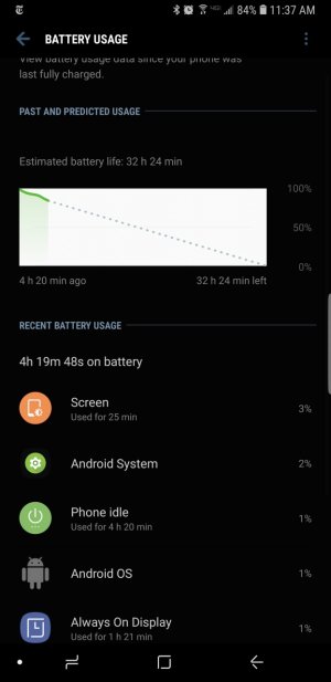

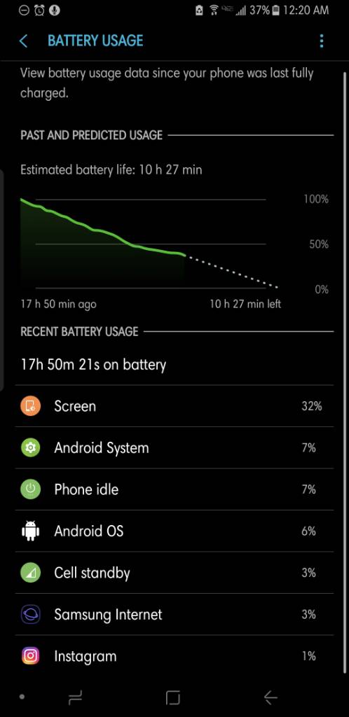

Attached is my battery life yesterday or the day before, can't remember.
I'm getting through the day easily and sometimes even 2 days, although I'm not a heavy user......

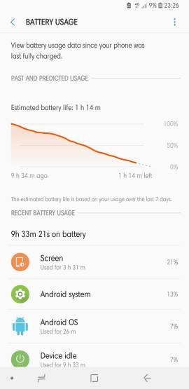

same problem here with Note 8...Indian version...barely last a day...I charger it twice daily ....that's y jumped to S9+ 128gb blue color....Thou still have Note 8 and using it till today will start to use s9+ soon...will be doing unboxing video for s9+

battery life has really become worse after Oreo....I thought it would improve....I think most people will have to do a hard reset....

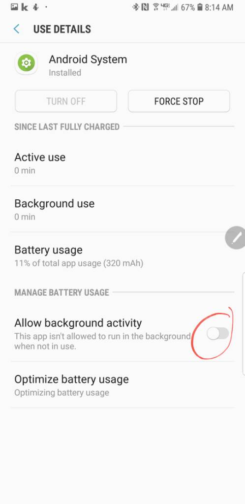

Had the same issue, disabling background use for Android System resolved the issue sir me.
In the battery usage tab on Android System and disable background usage. Battery life improved a lot.

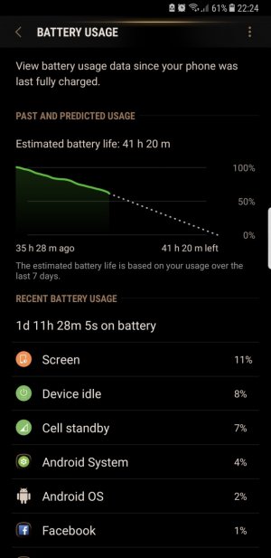

That's not the answer - I am getting two days out of my battery on my Note 8. Also, someone told me to try High Performance Mode and I ended up getting BETTER Battery Performance than I was getting with "Mid" Level set. If the "Wipe System Cache" doesn't work, then the Factory Reset will need to be done... something is causing that Android System % to be far too high - mine is usually around 2% or 3% in a 12 hour period!
