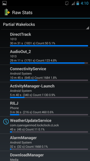

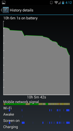

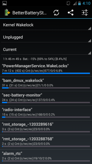

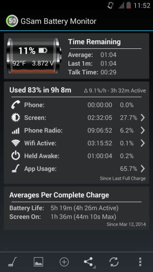

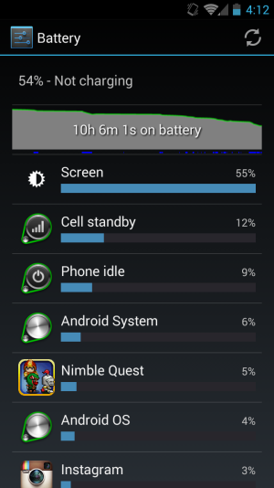

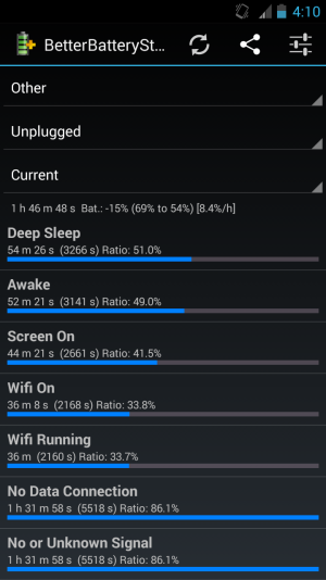

Here is some stats with better battery stats. Screenshot_2014-03-12-23-52-26.pngScreenshot_2014-03-12-23-52-26.pngScreenshot_2014-03-17-16-10-07.pngScreenshot_2014-03-17-16-10-17.pngScreenshot_2014-03-17-16-10-55.pngScreenshot_2014-03-17-16-12-22.pngScreenshot_2014-03-17-16-12-28.png
