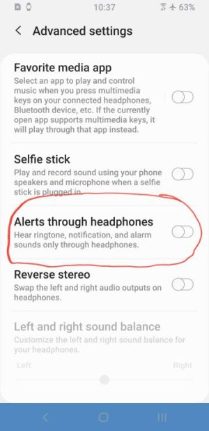

Turning this setting off won't do it?
This is an S9 on Verizon and Pie. Screenshot_20200115-103816_Sound%20Assistant.jpeg
It is in Galaxy SoundAssistant app. Guessing it only relates to wired headset - but haven't tested yet. It doesn't mention Bluetooth.
