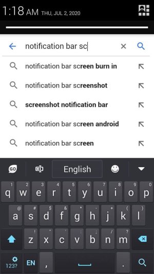

I don't wanna do that :(
Here's a photo though. Sometimes the notif bar just gets stuck here and sometimes it comes halfway through the screen.
The problem its happening in safe mode which means not 3rd party apps causing this , so not really much more can try .
