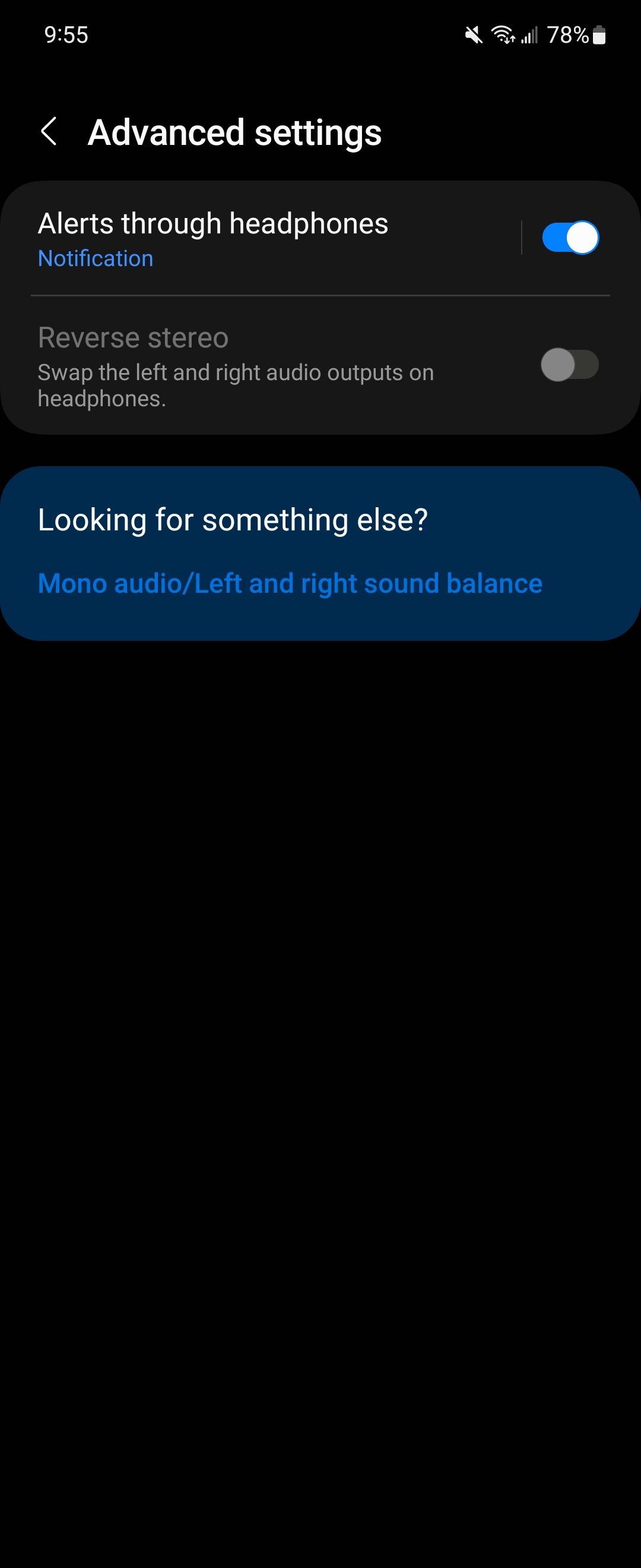

I did check the Do Not Disturb and it is off. I downloaded the Sound Assistant on the Galaxy Store and the Alerts through Headphones setting is off under the Advanced Setting. All the notification settings look normal.
Did I miss a setting somewhere that is playing the notifications through wired headphones/Bluetooth buds and not the phone speaker?

Screenshot
Sent from my SM-F721U1 using Tapatalk

So just uninstalled and no change. Phone will not play custom or stock notifications. I did capture the settings of the Sound Assistant in case something was wrong there.
EDIT: Under Permissions, it said No permissions allowed. (Not able to add the image)

Permission I had microphone enable
