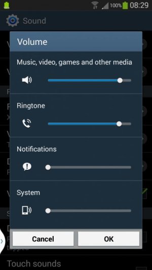

I recently updated the software on my Samsung Galaxy S3 to the latest Android version (4.3). Ever since then, whenever I switch my phone to vibrate or mute, and then switch back to normal sound, the Notifications Volume stays muted and doesn't go back to its original setting.
Obviously this is quite frustrating as I often don't hear when I get a message. I've tried restarting the phone, and also installing Volume Control + app but to no avail. I'll leave factory reset as the last resort for now. Any other suggestions?

I noticed that in your OP the 'System' volume was also turned down - is that a side effect of this problem or do you just leave it turned off by choice? If the latter, you might try turning it up just a little and see if that has any effect on the problem.

No it's not a side effect, I turned it all the way down so I don't have to hear system sounds. I don't want to have to turn it up to get rid of the current issue because that defeats the purpose of seeking a solution (i.e., it creates another problem, because in past I was able to have the system volume muted and not experience the current issue).
