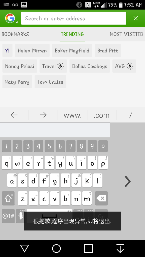

I just did an OTA update on my LG G5 phone (Verizon) to Android 7. Now, anytime I get a notification, there is a box with Chinese text on the bottom.
This also happens every time I call the keyboard as well as seen in the screenshot. Anyone else seeing this issue or know of a fix? This is driving me nuts.

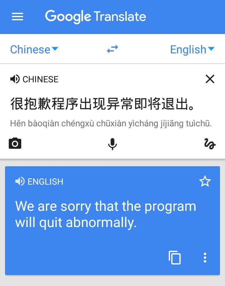

It looks like an error message from an app that is not completely compatible with nougat. Check your running apps and see what apps are on that list. Do you get the same message on safe mode?
Thanks for the translation. The message does not appear in safe mode. Now I just have to find out which app it is.
