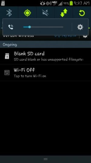

Today's.......looks like a reboot is in order..
Sent from my SCH-I535 using Android Central Forums

OK I did all....but can't reformat my card. Every time I try it tell me windows is unable to format card. Does that mean I have a bad card???? Does that mean I return to Verizon?????
That would be my first guess and would explain all your problems.
