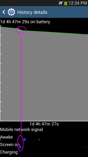

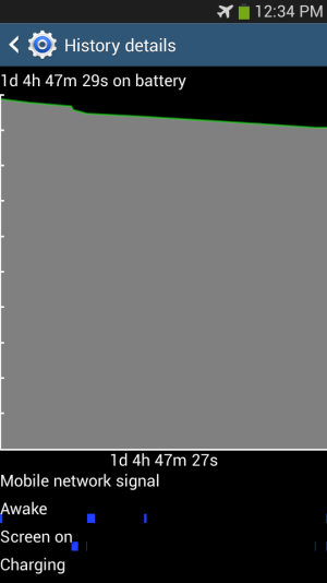

...And the term "sleeping", is that any time the screen is off?...
I have thought sleeping refers to when the phone is not awake in the sense of what is shown upon going to: Settings > More > Battery, and then tapping on the graph. For example:
But, looking at about 6 hours into the 28+ hours shown above (where the biggest drop occured), this would indicate the phone can be 'sleeping' even when the screen is on!!!???
Thank you for this. I had never tapped that graph before. Another avenue to explore!
