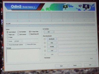

Next, you will need to download and install ODIN.
[TIP]Once done, you should start it by right clicking and 'Open as Administrator'. This option works best for using ODIN in general.[/TIP]
This is ODIN just after the program has been launched.

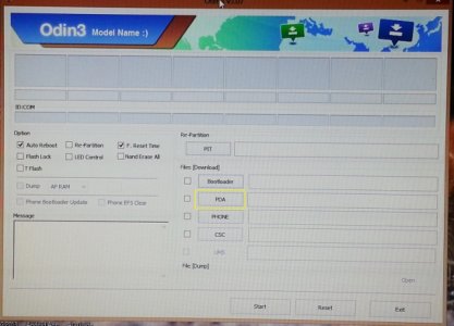

The MD5 file would go into the PDA box. Sounds weird, I agree, but the PDA box will be your best friend. You don't need to worry about any other Boxes.
This is the PDA box that will be needed to flash any file.

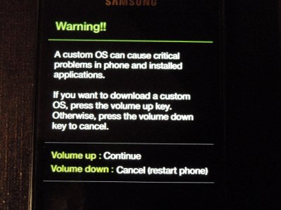

Once the file is in the box, you would now need to turn off your device, and reboot into Download Mode by holding volume Down and power (If using the Galaxy S3 and 4, Home will also have to be held).
This is the first step to getting to Download Mode.
This is what Download Mode actually looks like.

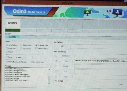

Note the COM:3, and the MD5 file in the PDA box. Now, to begin, just click Start.
[WARN]At this point, DO NOT remove your device until ODIN says finished, or if something goes wrong, it will say failed.[/WARN]
ODIN flashing has begun.

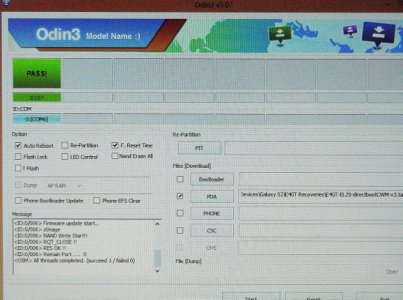

When ODIN is done, you should see a box that will say reset or passed (depending on which version you have, you may see either or both.). At this point it is ok to remove your device.
ODIN fishing up it's process. Testing the reset.
ODIN has completed the flash, and by now, the device should be going through the reboot screen.
