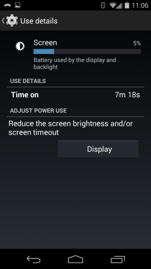

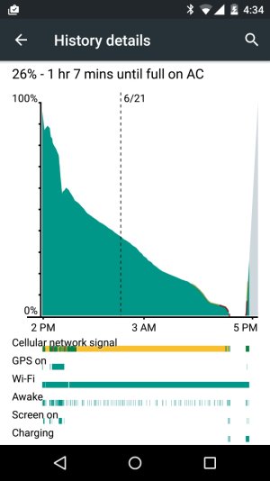

I don't use my Nexus 5 anymore, it's my backup device when I need mobile data only. I started losing faith in my N5 after I installed a new battery, but the battery life was still atrocious. It wasn't the screen on time that was bad, but the stand-by time that was bad. This was my N5's battery life as of yesterday/today.
And the screen on time:
I used my N5 as a GPS for 2 hours, from which it went from 95% battery to about 60%. I forgot about my N5 and left it in my car, and when I went to get it around 4 PM today, the battery was dead. It went from 60% to 0% in less than 24 hours, which is quite typical for my N5. My Moto G on the other hand can be left on stand-by for a week before the battery dies, and that's with 1-2 hours of screen on time and while still getting notifications from Facebook/emails/etc.

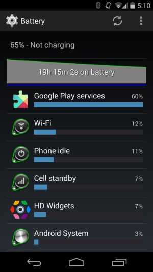

It's because of the Google Play Services. I rolled back to 4.4.4 and I still have the same issue.

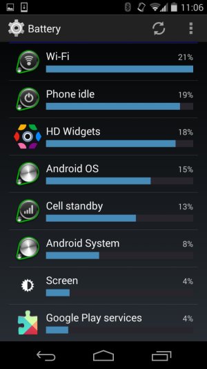

Well I looked around and I disabled as many of the Google Play services as I could. I set Location to Battery Saving, and I turned off all the syncing except for Gmail. I definitely saw an improvement in battery life, but it's still not good. It's gotten better but it's still not good.
Stand-by time uses roughly 22% a day now, instead of 30%-40% a day that I used to be seeing on my N5. Google Play services only used 4%, compared to 60% when I didn't have most of it disabled. Stand-by time with KitKat is also much better than with Lollipop - with Lollipop I would see a 50%-60% drop in just a day of stand-by.

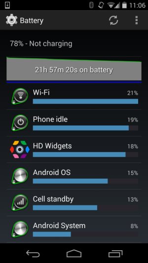

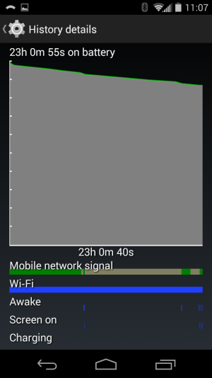

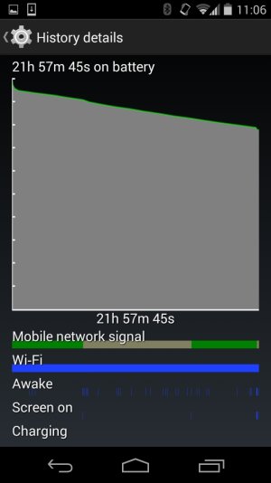

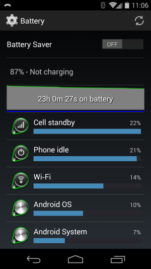

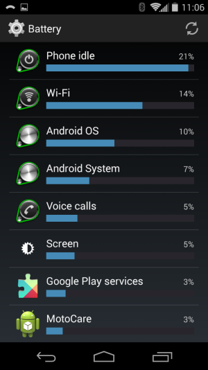

But it's still not good, this is my Moto G the past 23 hours.
It only used 13% battery life on stand-by. And I rarely used either of these phones yesterday, they were both just sitting there.
This means my N5 will last about 4 1/2 days just sitting idle. My Moto G will last about 7 1/2 days sitting idle. It's a pretty big difference.
My best guess is the Snapdragon 400 is just much more power efficient than the Snapdragon 800 when sitting at idle. Either that, or HD Widgets is a huge battery suck. In either case, the N5 hasn't been my main device for a while, and I don't see it becoming my main device either. I don't use my phone very often anymore, and my main priority is battery life, especially during stand-by.
