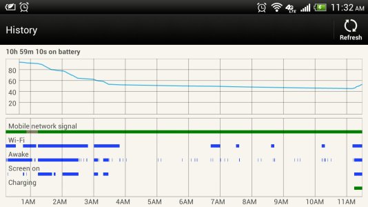

I've had my One X+ for about 5 days now and I really like the phone, except I'm very disappointed with the battery life so far. First, it takes a very long time to charge. I downloaded an app which would give me the history of the battery percentage, and last night I plugged it into the included wall charger at 15%. It took a full 6 hours for the battery to reach 100%. That seems like an unusually slow charge. I've even seen many times where it is plugged in, and I'm downloading an app, listening to music, and browsing the web or playing a game, but yet the battery is still decreasing! I've seen that before using a USB charger, but not a wall charger. That all wouldn't be so bad if it stayed charged. I intentionally didn't use the phone much this morning, only checked a few emails, no calls, wifi off for most of the time, bluetooth off, and about 45 min of pandora streaming over LTE. By noon it was down to 50%. At noon I started playing Hill Climb Racing, which I consider to be a fairly non-cpu intensive game to play. After playing 15 min it had dropped down to 35%. I can't imagine this is normal, right? Is there such a thing as getting a bad battery in a phone? Should I try to exchange it?
This is my first android phone moving from an iPhone. I realize that having widgets and such can drain your battery, but I don't have many on the phone anyway.

Something is definitely wrong. I have yet to get on LTE but I don't think a battery should be discharging that fast. On my HOX+ I'm getting very good battery life with social networks, gmail and weather set to auto sync. When my battery reaches 35%, it only takes me about an hour to get back to 100%. When phone is off the charger, it will drop to about 85% if in standby for 8 hours or so.

I have a quick update on this. I went back to the AT&T store last night and told them what was going on. They gave me a new phone with zero hassles. I got home and got the battery down to 10% by installing all my apps back on there. According to the battery manager, it took only 2.5 hrs to charge back to 100% which is much better than the 6 hrs needed by the other phone! I'm hoping that today shows the battery life lasting much longer then on the other phone!
Standard usb HTC charger is about 1.2 amps we need a 2 amp like a tablet. I got a 1.5 amp car charger it dose the trick ,on a 15 min ride to work. It's bc of the tegra 3 quad core. If your gaming and streaming music. Your going to be taking more energy than what's being put it. Think of it as running bath water with the drain open. It will just becomes stand still and the tub won't get full. And letting it get that low isng good for the batterry.
