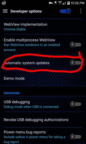

I have the Verizon V20 and currently blocking the Oreo update. On it, I can boot onto recovery and clear the system cache, but unfortunately it'll just download the update again and start nagging me. I just gave up and have just resorted to force closing the system update app when I reboot my phone to make the notification go away. I don't reboot it often, so it's a small price for my purposes.

Thanks! Theoretically, if you have auto-updates turned OFF in the Google Play app, the phone should not auto-update even system updates, right? I managed to evade automatic system updates for 2 years this way and only manually updated when I decided to. Unfortunately, I thought I was only getting a security update when in fact it was time for OREO and as soon as I realized what it was downloading, there was no stopping it. It seemed to want to resume each time the phone breathed.
I wonder if when you boot into recovery mode and clear system cache, do you have auto-updates turned OFF? Because if you do, I'm wondering if the "cleared" system cache did indeed actually contain the unwanted downloaded OREO file(s) or might those files be cached elsewhere and the phone is picking them up from somewhere else. Because I would think that with auto-updates turned off, it shouldn't be seeking to download anew. If you haven't tried it with auto-updates turned off, I'd be very interested to know what happens if you do.
This is incorrect. That setting in Google Play only applies to individual apps in the Play store that you have installed. It does not have anything to do with the OS updates. I'm not sure if yours would be the same, but on the Verizon version, that option is in the developer options.
But that may still not do what you want. On the Verizon version, it'll download the update whenever it wants, just not install it right away. Different versions of the same phone like this can have minor differences like this, so someone else with your version of the phone would have to chime in to verify anything like that.

Well, could possibly get a clue about that by monitoring the increase in internal storage used. Yeah, I didn't think the Google Play store would hold back system updates as well, but somehow I had the system updates set to manual because I never got them unless I selected to "Check for software updates and update your phone" located in the Update Center under About-phone.
I am curious to try your method just to see what result I would get.. not sure if I'm brave enough, though. :)
Oh Wow! I had developer options enabled but hadn't enabled the Demo mode. I just noticed "Aggressive Wi-Fi to Cellular handover. If I enable this, I might experience fewer dropped calls when walking away from Wi-Fi.
