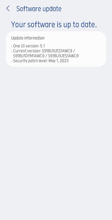

Update: I connected with Smart Switch and it says my software is up to date:
I wonder if it's the issue I mentioned in the post directly above about the update loop I had previously?
Yeah. It's been known that on AT&T branded Samsungs if it can't find an update OTA, Smart Switch won't find it either.
Over a year ago, this was an ongoing thread over on the AT&T support forum with one user conversing with one of the few AT&T reps who knew what he was talking about. That rep was surprised to hear the updating through Smart Switch didn't work like it was supposed to.
Apparently, AT&T's engineers haven't fixed that yet.

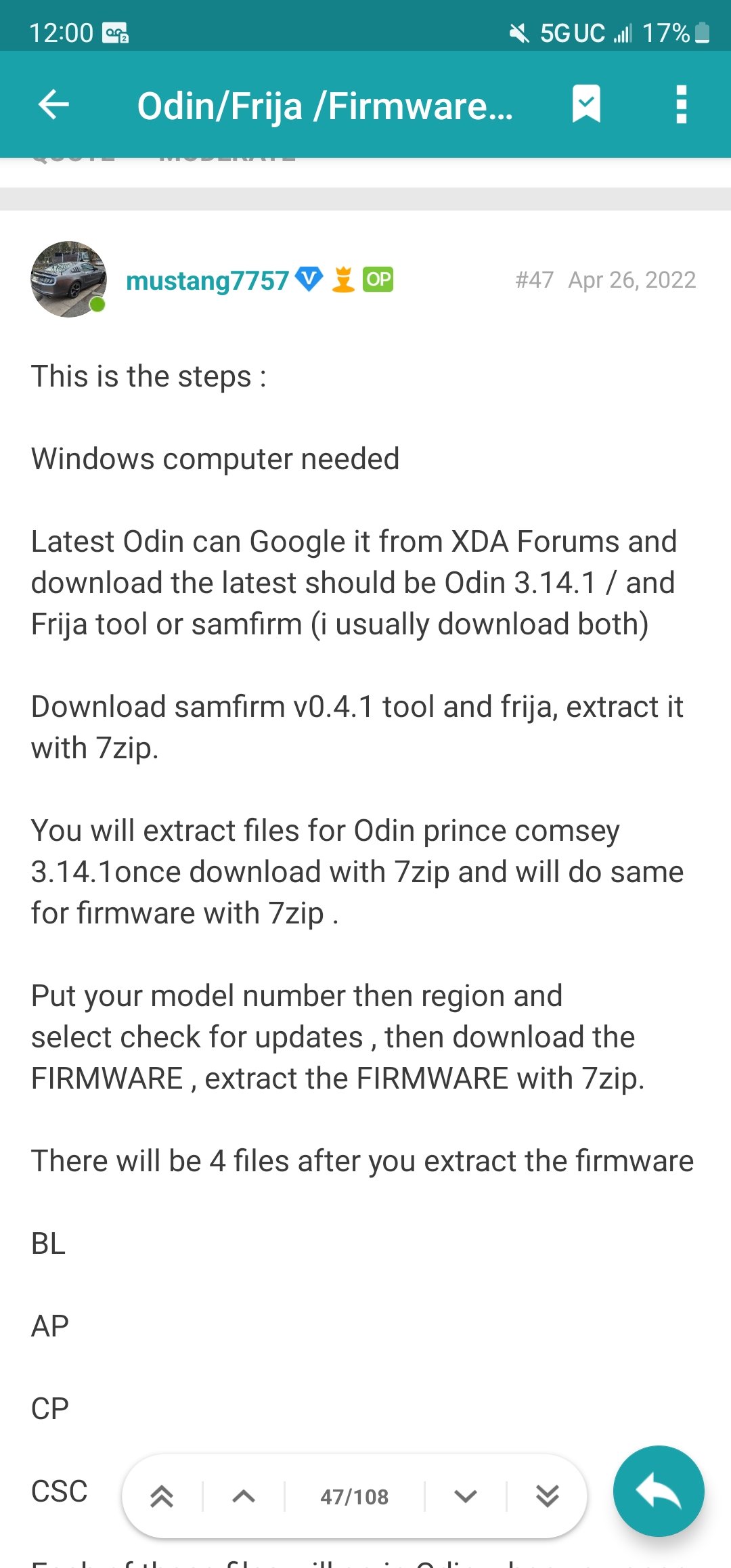

Follow steps here
Post#47
Frija doesn't have firmware for Att so use TMobile (TMB) CSC code and your model number

In post #47 how to do the whole Odin and Frija
No it wouldn't add TMobile stuff or delete Att stuff as all carrier versions are interchangeable
