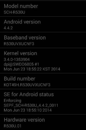

So I went ahead and tried towelroot. Was pretty stoked and thought it'd be the answer...but no. When I tapped the "make it rain" button it says "this device not supported".
Any other clue on how I can root this darn thing?
Did you read through the forum that's linked off the website?
Is the kernel on your phone dated June 3rd or later?
Sent from my rooted, debloated, deodexed Sinclair ZX-80 running CM -0.001 using Tapatalk
Yes and yes. Seems odd. Everyone else seems to have a good outcome with towelroot.
I contacted max lee with galaxys3root.com and he says his method will work. Im only hesitant cuz his article/method is dated July of 2012.
I will take his word for it and try i guess, but it just seems odd that everyone says you need proper root method for your current OS.

Yes AND YES. Seems odd. Everyone else seems to have a good outcome with towelroot.
Are you SURE you read through that forum? When I read through it last week the OP stated that Towelroot wouldn't work if the kernel was dated after June 3rd (which yours is).
Ah. Well apparently i read poorly. You are correct. I have too recent of a kernel.
Fairly amazing the battle i am going through to root this. Apparently i decided to root a few weeks too late. Every process seems to apply to older OS or older kernel.
Thanks for the replies.
GSDer, thank you for fighting the urge to call me stupid and stop replying. I figured I should update this with my status in case anyone else has an issue rooting a US Cellular S3 on 4.4.2 (perhaps I am the only one though)
Anyways, I tried/attempted several methods and had no luck. The MSkip method is too old for my OS, but since the process at galaxys3root.com is not OS specific, I thought it was the way to go. Everything seemed to go flawless. I made it through all the parts of the process where people were hung up, so when my phone rebooted and didn't get stuck in a loop I was stoked. Buuuuuuut, quick check with Root Checker and nothing. Said device not rooted. So I tried again, same thing...flawless process and reboot aaaaand nothing. Then I plugged my device in and erased all existing superuser files (cuz they would install but something wasn't working), and did it again. Again perfect root process followed by a reboot that left my phone not rooted.
After talking with @zedomax he was also stumped. Then I notice the SuperSU file was in my "forced stopped" list. I restarted it, and nothing. But then I rebooted the phone and sure enough. SuperSU was in my app tray! DL'd Root Checker and yep, device was finally rooted.
Sorry for being so lost on this process.
