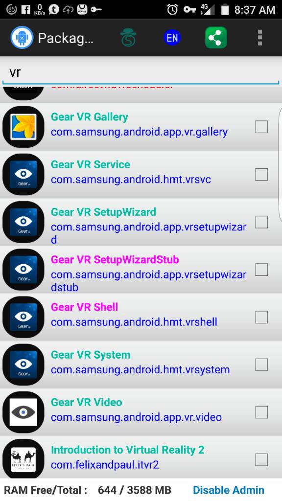

Has anyone figured out exactly what packages need to be enabled to allow Oculus to run correctly? I've disabled most of those mentioned in this post:
http://forums.androidcentral.com/sa...-package-disabler-pro-my-verizon-s7-edge.html
The problem I'm having is only when installing or updating Oculus software. The app or game will download via the Oculus app, but it fails to install. The quick workaround has been to just enable all packages to allow the install, then re-import the XML file to get back to where I was. If anyone's figured out exactly what packages need to be running though, that'd be great.
And no, I'm not ditching Package Enabler Pro, not after going from 2.5 hours of SOT and maybe 13-14 hours of total time on to 4+ hours of SOT and 24+ hours of total time on after installing PE.
Make sure that all Gear VR are not disabled.
I also have a problem with my gear vr oculus.. happened after i used package disabler pro to use the vr headset with other apps..

I had issues with my gear vr when i first got it could not get stuff to download or uupdate after a long while of research i found out you need the facebook app enabled and you have to run it atleast once for it to update somthing then run your vr let it update then disable Facebook again and it will work fine i dont use Facebook so it was the first to get disabled .

Bingo, this was it. Awesome, and thanks for sharing.
