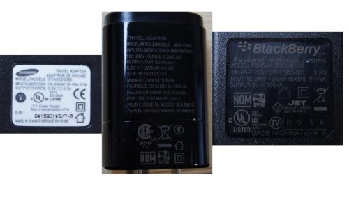

these are what i tried
stock n4 charger
samsung s2 charger
blackberry boldView attachment 48460 charger
At 0.7A and 700mA (these are two different ways of saying the same thing), both the Samsung and Blackberry charger are seriously underpowered as compared to the "original equipment" n4 charger which is 1.2A (A=Amps, mA = Milliamps).
It is conceivable that you damaged the phone's charging circuitry and/or battery by using those underpowered chargers. Not saying it is so, just that it is possible.
Doubtful that he damaged it as I'm willing to bet that USB charging and the wireless charging share a good deal of the same circuitry, and most wireless chargers are rated for between .5A and 1A max. Using a charger with a lower amperage rating will generally just result in a much longer charging time.

I have used underpowered chargers many times before on many electronic devices and never have damaged circuitry. That doesn't even make sense. Now, if it was a higher output, then yes, I can see damage occurring. Isn't there a button combo you can press as a full reset? I know on my moto Xoom, I have had it not power on at all, but when I held the power and the Vol + key , it actually got it working.
Even a higher rated charger should be fine. Voltage and polarity are the bigger issues in almost all modern electronics as the charging circuitry is generally desgined to limit the amount of current drawn.
I agree, I didn't mean higher output as in amperage, but like you said, voltage. Higher amperage can cause your battery to heat up, but it won't damage internal circuitry on your phone.
