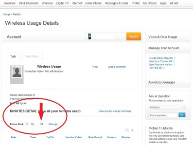

I believe this is an at&t only "feature." From a computer you need to login to your at&t wireless account and click on your phone, then Usage, then Usage Detail and ensure the Talk tab is selected. Then scroll down to MINUTES DETAIL and right under that you'll find the words Phone Book with the options On, Off, or Manage. Click on Off and then the phone book contacts will stop trying to sync. See the picture below.
