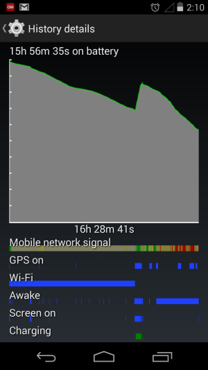

I want to confirm that my phone kept constantly on today when I had a missed phone call. I wonder if anyone else have this problem
Edit: Here is a screenshot of my battery stats from earlier today. Note that the screenshot shows no network available because I took it in the parking garage where my car was parked, but the problem occurred at work where I had okay reception. To repeat problem, place your phone in your pocket, have someone call you, and do not answer the call. You will find, at least with my phone and with pgoalz' phone, that your phone's cpu will be constantly awake, and the only way to un-glitch the phone is to reboot the phone. I have tried turning off the screen, clearing notifications, and placing phone on charger, and so far nothing turns off the cpu except if you do a reboot.
2nd Edit: I had motorola assist on with meetings activated because I was at work. I am unsure if this problem is created by missed calls in general, or if this happens when assist and meetings is activated and you receive a missed call.
