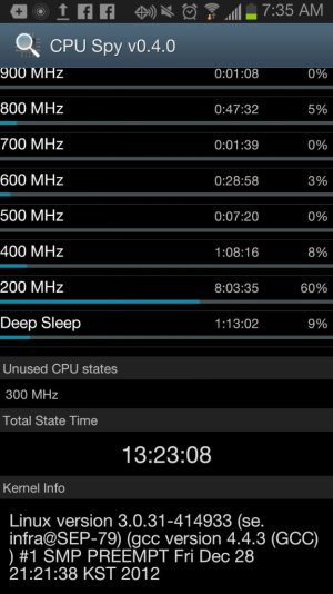

Were you able to get this solved. I'm the same way. I had to buy a new Samsung stock battery for my Sprint GNEX and as soon as it was installed, deep sleep is almost no more. And nothing has changed. When I install the old battery, I get Deep Sleep. I'm on a custom ROM (MMuzzy) too. I tried resetting batt stats, but no avail.
