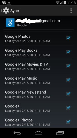

You might be misunderstanding me, or I might be misunderstanding you. In your screenshots above, I don't see the screen that details all of the Google components that you can check or uncheck for sync. Go to Settings, then under Accounts tap Google, then tap your Google email address. That should give you this screen:
Now, I also realized that Google recently changed the labels for photos that sync with Gallery and photos that sync with Photos, and it's hella confusing. "Google Photos" (near the top of the image) is for Gallery, and used to be called Picasa. "Google+ Photos" (at the bottom) is for the Photos app. I just tested this out myself by going to Settings>Apps>All, selecting Gallery, and Clearing Data, while also unchecking "Google Photos" as mentioned above. This cleared out the Gallery's web albums, but left the locally stored photos alone; and the Google+ Photos app continued to show all of its web albums. When I went and checked "Google Photos" again, it started syncing, and when I went back to Gallery, all of the web albums started repopulating.
Hope this wasn't too confusing ...

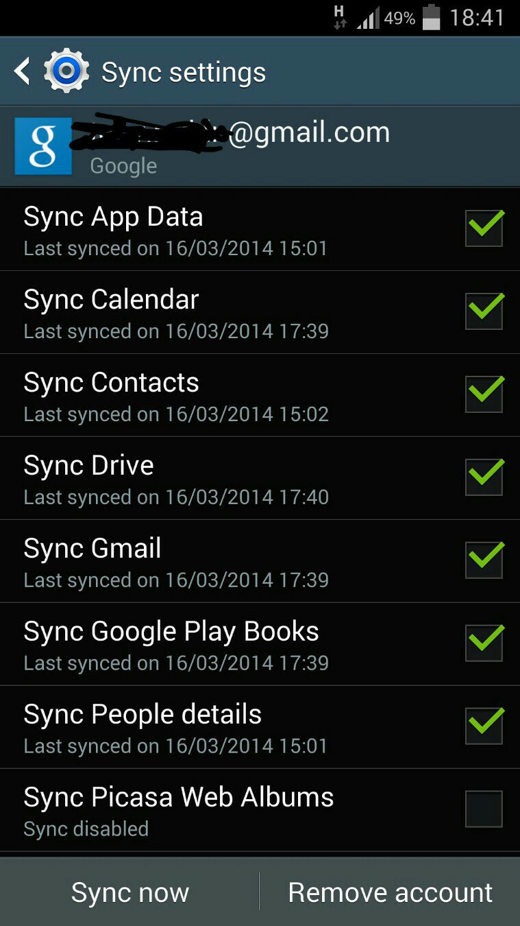

Yes, you got it now. But something changed in the last half hour while walking. It's showing now it synced 2 hours ago.
When the Google sync page was in red/cannot sync it wouldn't open the list. I remember your screenshot of course now I have seen it.
I unticked Picasa in the screnshot (and I will remove it) but I wish I had looked if it had synced as well. Would it have uploading 2gb of photos on 3G in a park? Would KitKat have installed the Picasa option and ticked all those boxes. I don't think I had them all ticked.
I will work on the rest of your helpful post later, and see if all is finally well.
Syncing only syncs thumbnails (not the full sized photos), and won't upload any photos. The only way photos are automatically uploaded is if you have the Auto Backup setting on. So the amount of data synced is pretty minimal. Glad this helped!
I think the default is to have them all checked, but I'm not sure.
