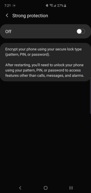

You have to turn off "Strong protection" in settings. It's under Settings>Biometrics and security>Other security settings.
Thank you! That was driving me nuts.

While it does fix your "issue", it's a really bad idea to do this.
Basically, your phone (and the data inside it) is now fully decrypted all the time, that isn't good.
He can still have a secure lock method (fingerprint, pin, swipe) to unlock the phone.
While I understand that this removed the encryption, the trade off is that I do not have to worry about NOT getting a page should the phone reboot. Unfortunately it is in my job's description to be accessible 24x7.
