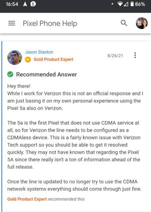

I am not into all the antenna tech. I found a similar answer in multiple places.Screenshot_20210902-165433.jpg
