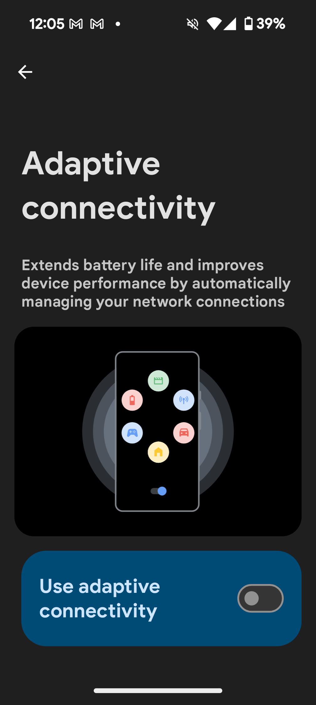

One suggestion to try in settings under connection see if disabling adaptive connectivity will help
Thanks...I've tried toggling adaptive connectivity on and off...did nothing. I'm leaving it off for now as I read that it was more inclined to keep people on LTE than 5G. I also tried resetting my network settings again...no change either...and sent more feedback to Google. Right now, I almost wish there was an easy way to add a Wi-fi toggle to my home screen to save the number of touches if I'm going to have to manually do this throughout the house.
  • Like
Reactions: mustang7757
Yeah I would suggest leaving off for awhile
