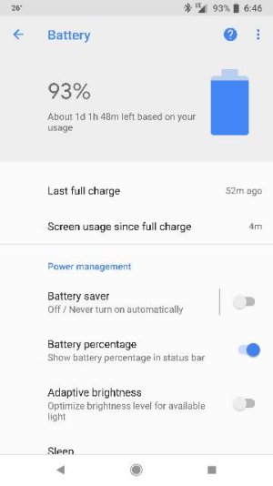

The battery on my original Pixel within the last week has started draining very fast.
Last night I charged it to 100% and went to bed without using it, this morning it was at 71% with System and Phone Idle using most of the battery. I could not find a single app that was over 1% power usage.
I uninstalled some apps and turned off AOD, charged it back up to 100% and let it sit for an hour.
57 minutes after it was unplugged with screen not being turned on for a second it was down 10%. Is anyone else experiencing this or have any idea what may be causing it.
Your "app usage" data is at 66% so something is running in the background. I use the "All-in-One Toolbox" app set on "auto boost" and the "Greenify" app set on "auto hibernate". When I go to bed with 100%, it's always at 92 or 93% after 9 hours sleep.

Have same story ..unplug from charger in 6 am and after 10 min it's already 98
