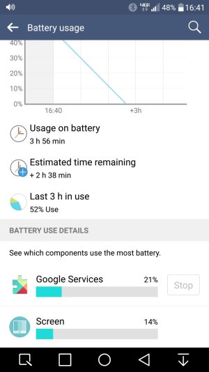

Google Services...
Can I do anything to get this down or do I have to wait for their next update! This is ridiculous!

You can disable Google app and Google play services. Keep in mind that some apps might go wonky or might not work at all without gps

Try using GPS only for location and turning off sync for any Google services you don't use.
This appears to have fixed my play services battery drain. Play services were at or above the level of the screen as far as battery % used for me. So far after this play services aren't even on the chart.
1) Go to Settings / Apps.
2) Swipe down until you find Google Play services. Tap on it. Tap on "Uninstall updates".
I wiped all caches and data for it after uninstalling updates. Not sure if that's necessary.
3) Go to*https://forums.androidcentral.com/e...ails?id=com.google.android.gms&token=XhCqnZTn and update Google Play services.
4) Reboot

Yup, that's the generally-accepted way of making wonky Play Services stop misbehaving. Every time it updates it seems some devices go nuts randomly.
I've had Google Play Services high battery usage myself, but when trying to fix it, I found that I don't have the option to Uninstall Updates in that app....there is only the Disable option, and when clicked, a message stating that the app cannot be uninstalled.

Turning off Google history tracking worked for me.

I'm not having it take up a high % of battery (less than 4%), but I thought I'd try this out "just for fun". When I went to disable it, I got a message saying "cannot uninstall: this package is an active device administrator" along with a "manage device administration" button -- when I clicked on that button I saw a few apps (Exchange, Key Plus, AirDroid, Screen Off & Lock, and Android Device Manager), with nothing seemingly having anything to do with Google Play services.

It's a funny old business. After changing a few settings, including turning off Location History, Google Play Services disappeared from the battery usage stats....but Android Services and Android OS appeared instead, with high usage.
At the moment, all three are showing in the stats, but only low usage. Why, I don't know, and whether because of my fiddling with settings, I don't know.
Also, strangely, I don't have the Fit app on my G4. I have it on my G3, disabled months ago when there were mutterings about it being responsible for battery drain.
Your links will be useful to others but at the moment I'm okay. :)
Actually I forgot but I ran into that too, turn off Android device manager and go back and try again. That's a play service too.

What version of Play Services does this reinstall? A newer version or older? What impact does this have on.... Anything?
It will install the most current version. I think it just forces a reinstall of the updates so that whatever was wrong or hanging might be fixed.
I get the same error another user posted. Can't uninstall due to a system administrator error
Have you tried this, "Actually I forgot but I ran into that too, turn off Android device manager and go back and try again. That's a play service too."?
